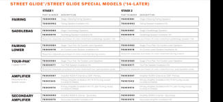

Could you please, share a pic of your head unit? The Boom Box 4.3 and 6.5GT units are still compatible with the RF systems. They would need a dealer activation though. The pic shows what is required to install the RF system on to your ride.
