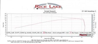

I have to disagree about the Screamin' Eagle Pro Street Tuner being "virtually worthless".
I just picked up a 2019 Heritage Softail with the 114 cu in engine. I put 7300 miles on it over the past 4 weeks and I can say it runs GREAT!
I had only three mods done to the engine: S&S EPA compliant slip-on mufflers with catalytic converters in them; H-D stage II Torque Cam; Screamin' Eagle Pro Street Tuner with the Smart Tune Pro Automatic Tuning Module. The bike has the stock air cleaner. It is fully EPA compliant and the Warranty is intact.
The bike was tuned on a dynamometer by the dealer. The H-D tuner can adjust both Volumetric Efficiency and Spark Timing as well as the Throttle Progressivity. This is all that is needed for a great running bike.
Here you can see the fuel table for the bike which can not be changed (to remain EPA compliant). It is not at all too lean as many people suggest.
Here is the SAE dynamometer performance chart. STD performance, as many report, would be over 105 HP and 123 TQ.
