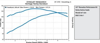

I heard that 110 is not a good choice but the same time I am seeing a lot of posts on how good it is. Then I am seeing 107 kit that is getting 110HP without the heads, with Woods 777 cam. I would like to be around 110HP with 107 kit without swapping out heads & throttle body & injectors.

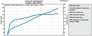

Besides the info you get here, I would also talk to Fuel Moto. Write a list of questions and concerns before you call.

You should get 110 rwhp (or very close to it) out of a 107. Keep us posted on your results.
Fuel Moto has many dyno charts on various builds that might give you a better idea on what combinations might meet your goal
