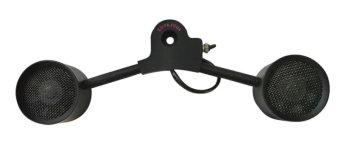

I am looking for a way to cool my bike during summer rides, especially in the city. Weather here is around 75 degree and bike is already heating up and shutting off one cylinder while I am at a stop.
I searched and found CoolFlow Fan by Harley. Does anyone using it, if so I like their feedbacks. I saw other ones like Jim's ForceFlow & Love Jugs, which one works best and why?

I'm going to try a set of Wards fans: Wards Fans

I don't know about Wards fans for couple of reasons; 1: takes several months to get one with deposit, 2: sounds as it's not made for traffic stop/go......and website sound very cocky.....whatever the reason behind that maybe ok for them but that's not how you do business. I will try another product.
But hulkss please keep us posted with your findings on Wards fans and thanks for sharing!

Forced air cooling with fans is not a band aid. Our engines are air cooled. Here you can see the hot area, right where the fans are positioned at the combustion chamber. This is by far the biggest source of heat generated by the engine.

BlkDragon : I bought the Wards Fan almost 2 years ago for my 2014 SGS. I mounted them as directed, couldn't be happier w/ the performance and have noted a reduction in cyl temps. A buddy of mine has the Love Jugs on his Harley but they look too big for me.
I believe the HD CoolFlow fan is for the new 2017 models. I'm not sure how easy it would be to adapt to an earlier model. I've heard good things about the Wards fans but for me, I went with FM Jackpot SS headpipes with a PV and that significantly reduced the amount of heat from the exhaust.

HD Coolflow fan is only to redirect heat from the rider/passenger so it doesn't really cool the bike....Forceflow or will look into other fans, more research to do on this and summer is creeping up faster than I can take it. Maybe stop riding during summer like some of you guys that live in cold country.....LOL!
