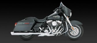

Actually there are 3 different head pipes, Power duals, Dresser duals and True duals.....Power duals provide more torque than the rest is what I was told....I guess Dresser duals & True duals are pretty much the same as they are separate pipes but Dresser duals also route under the frame as True duals doesn't....see attached pictures:
Power duals
Dresser duals
True duals

Here you go!
Power duals & Dresser duals are pretty much exactly the same as picture below:
189676d1307284518-v-and-h-power-duals-crappy-heat-shield-or-v-and-h-power-duals-004.jpg
underneath of Dresser duals
True duals.....

The only real difference in the exhaust routing on the true duals... obviously since the rear cylinder exits on the left side, not like true duals or PowerDuals which routes under from right to left...
True duals..
